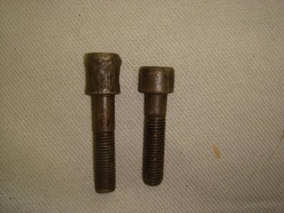

    Quote B.G. "Hipo rear leaf springs are also unique in another way. They have a taller locating pin that is necessary to be used with the 9 inch rear end. Because of the radius of the locating hole in the 65/66 9 inch housing the normal length locating pin will not go up far enough into the housing which it needs to do to locate the housing properly . The result of the rearend housing not being located properly will be that the rear of the car will track to the right or left when driving. Those who just change the bottom plate to a new set of springs might have a problem and not know it if the correct pins are not used
  8. Bob Gaines
    The picture shows the long and short pin. The longer one is the one that came on the hipo springs used with the 9 inch 65/66 rear ends. Bob
