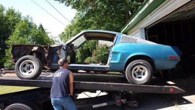

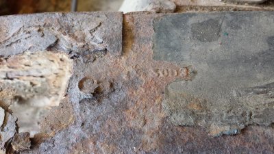

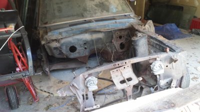

    We have a shell of a 68 Mustang but we don't know if it is a Shelby or not. Have no clue if it had Shelby tags on it and if it did where they would be but from what I am reading Ford took over in 68 and named them Shelby Cobra's and Carroll Shelby was not a part of the process anymore and did not sign them anymore. It has been really stripped down as you can see from the photo's. My question is it a Shelby Cobra? I know it won't have the signatures etc cause in 68 they didn't do it anymore. If it is a Shelby Cobra does anyone know the value of it?
    What I know about it is it's a 1968 made in Dearborn MI, 302 engine, 4 speed, made Dec 29th 1967. That's all the info I have on it.
    Any help would be greatly appreciated as we are looking at restoring but have no clue what it really is.
    VIN 8F02J133591

    Nope, not a Shelby, just a really rusty "J" Code (302 4V) Mustang fastback. Sorry to burst your potential financial bubble.
    Order a Deluxe Marti Report at http://www.martiauto.com/reports2.cfm
    This will assist you in knowing how the car was originally equipped.
    Bill S.

    Bill isn't trying to fool you .It is extremely easy to tell that your car is not a 68 Shelby because the plant code "F" is Dearborn and not "T" Metuchen were all of the 68 Shelby's were made.

    You are very confused. Shelby was involved in 1968, just as much as the other years. All ( not most) 1968 Shelbys were built in the New Jersey assembly plant. The cars were finished in Ionia, Michigan. However there are no codes or indications of this conversion on the cars, tags or in the codes.
    I am puzzled what you mean by Carroll Shelby never signed them?
    The car you have was built in the wrong plant and has no Shelby specific or unique codes. It also doesnt have any of the Shelby specific body modifications. That is based on the warranty tag info you posted. Additionally, all 1968 Shelby serial numbers are known and there were no Shelbys with the VIN you provided.
    I guess I should ask, what made you think it was a Cobra? Ford made Over 300,000 Mustangs in 1968. Only 4450 are real Shelbys. In other words, just based on production numbers there is a 99% chance its not a Shelby to start with...There are no Shelby unique parts in any of your pictures, no indications the car is a Shelby at all. Hope that helps...
    As for price, you have a car worth about $5,000 or less. A similar Cobra would be in the $60,000-75,000 range.

    I cannot imagine from the photos that there is enough to salvage and do a mod-Mustang there for $50,000, even with the work done by the owner. And, for the record, the Eleanor in "Gone in 60 Seconds" was never a Shelby Mustang nor did Shelby American make any. They are modified movie cars that many like to look at.
