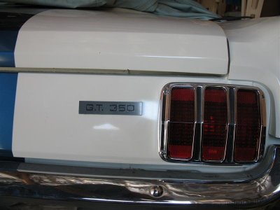

    Hey guyz, can anyone tell me the exact placement of the rear GT-350 badge on passenger side rear filler panel of a 66? Is it equal distance from the stripe to the tailight? Also, purchased a heater delete panel from Branda and has anyone installed one of these? Is it epoxied in place?

    There may not have been an "exact" location being a Shelby. But mine is about 2 inches to the left of the tail light bezel.

    I've been told there was no template for placement of the rear GT350 badge. The exact location can vary - even between sequentially produced cars - because it was just whatever "looked right" to the guy that was installing them when your car came through. A few cars didn't even get a badge.
    Maybe one of our concours judges will chime in and either confirm or correct this information.
    Until then, I suggest looking at other cars (in person &/or photos) and then pick the spot that looks best to you.

    May I direct your attention to The Shelby American, issue #58, page 19.
    The Cobrasations interview of Bob Wyatt, Shelby American truck driver,
    and production supervisor.
    On page 19, there is a picture of Bob, pointing to the rear GT350 badge,
    and the remark is: "Wyatt recalls the problems he had in making sure the
    employee who installed them had the TEMPLATE right
    side up!"

    Doug, you are so cool! That looks like the smoking gun that shoots down the myth about no template. That also may explain why some were in a different position than others - a (sometimes) upside-down template.
    Thanks for setting the record straight.

    thanks to all...a couple of inches to the left of the tailight (centered) it is. oh yea-right side up would help to

    In reference to the Bob Wyatt remark in issue #58 Of The Shelby American;
    I would tend to believe there was a template to be used, but when dealing
    with people to accomplish tasks, sometimes the result is not as desired.
    Since there is inconsistency in their ( GT350 badges ) placement, I would
    suggest that some SA employees perhaps used a template, while others
    simply ignored it.
    And then, we have the cars that never got one...........

    Suffice to say then, placement of the GT350 badge is an approximation
    of observed positioning. The variances are neither right, nor wrong. Only
    accepted.
  16. Bob Gaines
    I hear what you are saying and I am sure we are on the same page but just to clarify for those that may be reading but not be sure- the emblem position is accepted as long as positioned is within the normal range of area the emblem was normally seen positioned. Any radical placement would need some reasonable documentation. example- radical placement several inches left of passenger tail light , inches far up towards the trunk lip,or far down towards the bumper. Examples are not the normal variations. Just don't want to give the impression that any old position was good. Good examples can be unrestored cars (baring damage),restored cars that have not had a tail panel replaced ,original tail panels that have been replaced but still retain the holes for thpins,vintage magazine articles from back in the day just to name a few. Bob

    The rear emblem on my car is located about 3/4 inch too high. The following story is true.
    Shortly after I bought my car in 1979, I was working at the tech director at the local NASCAR track. One Saturday night I parked my car on the infield. (After what I saw later, I never got my car within miles of the place again). I had a number of people looking at it. One older guy in particular checked the car out, walked up to me and said "This must be a really early car" I asked him how he knew, he said because of the rear emblem, it's located too high.
    He told me he was working for Shelby American in '65. They assigned the job of mounting the rear badges on some of the cars to a kid who screwed it up. They gave him a template, a drill and some badges. Apparently, he didn't pay any attention to what he was doing and located the rear badge on some cars noticeably too high. The guy who told me the story said couldn't remember if the kid assigned to install the emblems had the template upside down or not but Shelby management was very upset about it. Since it would have been very expensive to fix, they sent the cars out that way. The kid got fired over it. I managed to make contact with him last year. He is in his '80's now but he remembered our conversation and confirmed this story.
