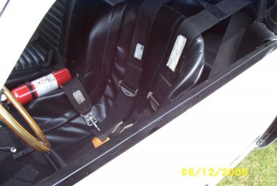

  11. mustangpete1013
    mustangpete1013 New Member
    Apr 23, 2005
    Delta Bay Mustang is located in California USA.They do have the seat for sale.
    I bought mine there and it looks great.You have to get a little creative getting the seat bracket(they also sell this) attached to the seat .
    Their website is deltabaymustang.com and look under high performance parts.There you will find a list of all their R model parts including the seat.
    The picture is what it looks like in my car.
    Good luck,
    Pete.
