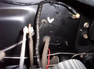

    If you send me a personal email with your email address I will
    send you a picture of my 65 and of my friend's 66.
    Texas Swede

    The size of this picture was okay to post here.
    Texas Swede

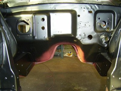

  4. Texas Swede
    Texas Swede Well-Known Member
    520
    Oct 11, 2005
    Richardson, Texas
    This is my 65.
    Texas Swede
  5. 2+2GT
    2+2GT Well-Known Member
    223
    Aug 1, 2009
    I agree. On an undrilled firewall, this dimple marks the spot. Use the same grommet that goes around the fuel line in the lower part of the left-front fender apron.
