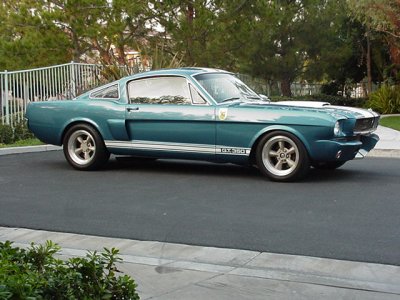

    This is the one I sold earlier this year. Gardsman Blue is not the same. It was actually a T-Bird color called Bright Blue Metallic. Dupont number is 4735

    Yes I know it was a T-Bird color, the color of the car looks to be exactly the same as the car in KenG's post. It is close to a Acapulco Blue but has a bit of green in it. Commish, it the dark blue 67 color you are refering to possibly Nightmist blue (navy blue). When we put the dupont color code in it said bright blue metallic and the ditzler code said guardsman blue. There are guardsman blue stripes on my 66 continuation car and they seem to be exactly what was mixed for the sapphire blue. O well we will see by this afternoon how it looks. I will let you guys decide if its right. Thanks! :D
