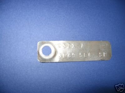

    Here are two pictures of 65 tags:
    1. Was for sale on ebay $400 and is dated 5EC, Third week of May, 65
    2. Is my repo tag made by Marti using an original as a guide.
    Only the date was changed from 5BC to 5CC to match my pumpkin's
    cast date which is 5B17. Otherwise they are identical.
